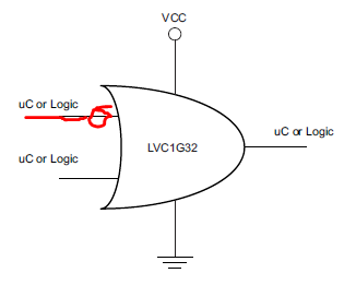

Can you help to check if we has a pin to pin part but with a invert input of this OR gate as below? SN74LVC1G32DBVR
Appreciate your support.

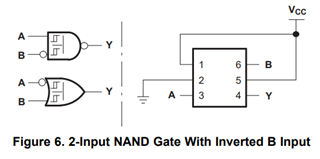

We have a few "configurable multi-function" logic gates. Such as the SN74LVC1G57. However, they all have the same pin layout and will not be a P2P replacement as they need 3 inputs to have configurability (see below).
If you need to have a single inverted input, you can also try to add an inverter before the OR gate input.
