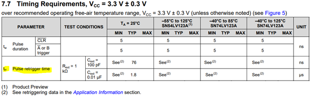

1. Which of tMIR (= 0.3 x tw), tMIR (tPLH + tw) and trr is the minimum retrigger time?
2. The data sheet "10.2.1.3 Retriggering Data" states "the two adjacent input signals must be tMIR apart, where tMIR = 0.30 x tw.".
Which of "7.7 Timing Requirements, VCC = 3.3 V ± 0.3 V" and "7.10 Switching Characteristics, VCC = 3.3 V ± 0.3 V" is this tw?

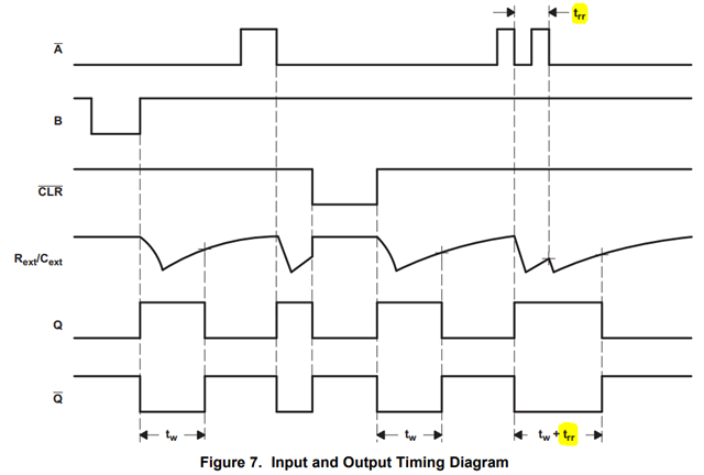

    t_rr is the pulse retrigger time:
    This value is shown in the timing diagram here:
    In the applications section, the datasheet also defines t_MIR as the minimum input retriggering time, which is the same as the minimum t_rr value. See image below and compare to above.
    The difference is that t_rr is the retrigger time, which can be a minimum, typical, or maximum, while t_MIR is only the minimum value.
    That is correct. The time between the two input trigger events must be at least t_MIR apart. In the below case, the trigger event is the falling edge:
    The amount of time that is added from retriggering will be the output pulse width (K*R*C) plus the propagation delay to the output (t_PLH). In long pulses this is not a major issue due to the propagation delay being only a few nanoseconds, but with short pulses, this can be signficant.
    The t_w they are referencing here is the output pulse width (as shown in Figure 10)
    This value will vary depending on your selected timing components.
    To be clear:
    Timing Requirements explains what limitations there are on inputs from the designer / system.
    Switching Characteristics describes measured outputs of the device.
    The output pulse width, t_w, is thus in the Switching Characteristics table -- assuming you are using one of the values shown for your timing components:
    The datasheet also indicates that the output pulse will be active 15ns after the trigger input --  it is providing a typical delay. Again, with longer pulse widths, this won't have much impact, but with short pulses this could cause the output to retrigger after the timer expires, creating a double pulse (as shown above) instead of a single pulse as desired.
    -> If the minimum value of t_rr and t_MIR are the same, how do you calculate the minimum value of t_rr (listed as "See" in the data sheet)?
     Is it wrong to calculate like t_rr = t_MIR = t_PHL + t_w?

  • Hi Nishie-san,
    t_rr(min) = t_MIR = 0.3 * t_w = 0.3 * K * R_T * C_T
    t_RT = t_PLH + t_w = t_PLH + K * R_T * C_Tword

  • Hi Nishie-san,
    t_rr and t_RT are not exactly the same. Please see my previous response for the mathematical definitions
    t_rr tells you the minimum spacing between input trigger signals.
    t_RT tells you the amount of time added to a pulse due to retriggering.
