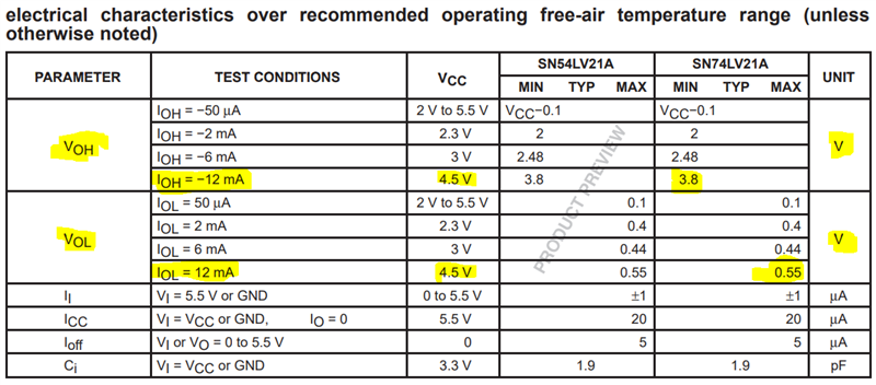

Hi team,
Please help me review the schematic
And I want to know What type of SN74LV21APWR output? Does it need to pull up?

Hi Andy,
The SN74LV21A has push-pull outputs as explained by the VOH and VOL specifications in the datasheet:
No, this is a push-pull output device.
