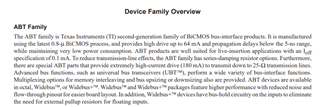

SN74LVTH245A 3.3-V ABT Octal Bus Transceivers With 3-State Outputs, What is ABT?
- What is the difference between SN74LVC4245A and SN74LVTH245A
Hey Rhea,
Here is an overview for ABT:
The SN74LVC4245A is designed for level shifting, whereas the SN74LVTH245A is just a standard bus transceiver.
