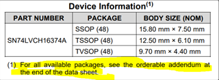

You can see a similar question answered here: SN74LVCH16374A: BGA package alternatives .
As Emrys explained, BGA packages are now obsolete in our TI portfolio. Checking the Package | Pins | Size tab on device pages will give the most up to date package options.

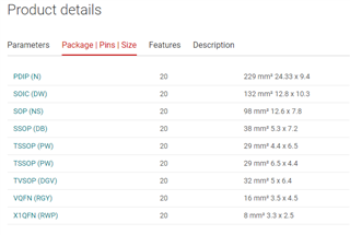

Would you recommend other BGA package alternatives and same function which we substitute the SN74LVC244AZQNR ? TVSOP package is too large for customer and customer already layout two year ago. We appreciated your great support.
There is no P2P replacement, and neither is there a BGA replacement.
The smallest package for the SN74LVC244A is the SN74LVC244ARWPR.
