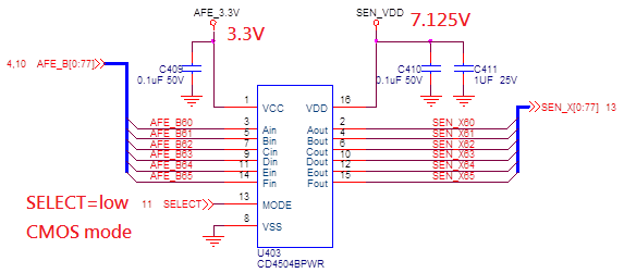

My customer would like design CD4504BPWR.
Would you please review parameters and provide your comment?
 Conditions:
Vcc=3.3V
Vdd=7.125V
SELECT=Low (CMOS-CMOS)
  1. What is Vcc spec in datasheet? Only Vdd is available in datasheet.
        2. What is the Vih and Voh under below conditions?
         Vcc=3.3V
          Vdd=7.125V

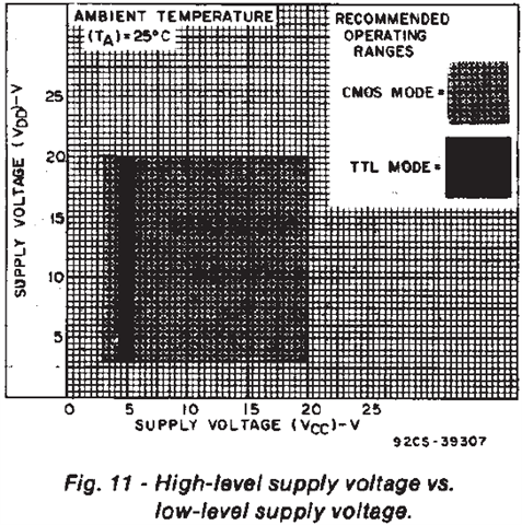

    1. Would you please let me know what the voltage range is? do you mean Vcc range is within 5V~18V?
    from below table, Vcc seems only 3V? (COMS mode)
    2. Would you please review scheamtic and provide comment? Vcc=3.3V, Vdd=7.125V, SELECT=low(CMOS mode)
    3. In CMOS mode, what is Vih and Voh values under below conditions?
    Vcc=3.3V,
    Vdd=7.125V
    BR,
    SHH
  • 1. The Recommended Operating Conditions table on p. 3 specifies a voltage range from 5 V to 18 V for all temperatures. Figure 11 specifies a voltage range from 3 V to 20 V for 25 °C.
    2. I see no obvious problems in this schematic.
    3. There are no guaranteed electrical characteristics for supply voltages below 5 V. But input voltages near the supply rails will work in any case, and with high-impedance CMOS inputs, the device driving the AFE_Bx signals will have no problems reaching these voltages.
