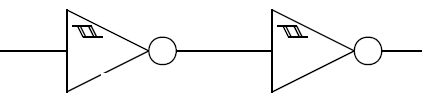

Are there any concerns like oscillation or something when they connect two channels of the IC in series like the attached?

No, this is a very common application for creating a buffer from 2 channels of the SN74LVC14A.
