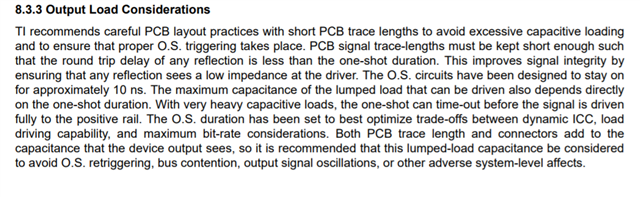

  • Hey Doner,
    I'd recommend reviewing this section:
    The outputs are a little more complex than what you are expecting due to the AC acceleration. TXU0204 provides a more traditional buffered output with similar impedance values and would be more robust in this circuit.
