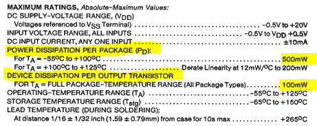

Hi Team, do we have any information about the thermal characteristic of this device?
Thank you.

Hi Mark,
There are some ratings in the datasheet, although they are not as detailed as our more modern versions:
Basically, for normal operation as a logic gate, there shouldn't be any concerns for power consumption. I wouldn't try to use this device to deliver any real power to a load though.
