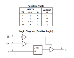

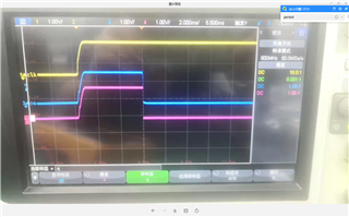

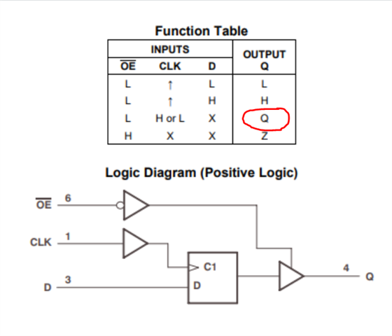

At the beginning, QE input H and CLK is High too.  Does Q output Z?
Then what does Q output when QE change from H to L and CLK remains H output?  Customer thought  Q's output will remain at Z, but it  outputs L level sometimes. is it normal?
schematic and waveform are shown as below.
