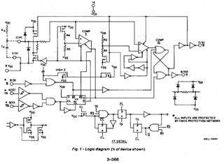

    The question is SN74LV123A、I think the following is a function block diagram of SN74AHC123.
    In this function block diagram, it is thought that the operation according to the datasheet cannot be performed unless CLR = GND and Rext/Cext are open, or CLR = GND and Rext/Cex = VCC (pull up to VCC with an or resistor).

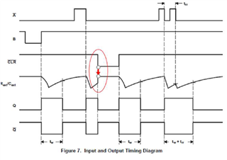

    Also, looking at the Figure 7 Input and Output Triming Diagram of the SN74LV123A below, Rext/Cext is forcibly set to High when the CLR changes from Hi to Low.
    From this, the operation similar to the above function block diagram can be considered.

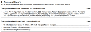

  • Hi cafain,
    From the revision table in the current datasheet:
    You can see that there were many formatting changes and additions to the datasheet from rev O to rev Q. It appears that "NOTE 5" from the original datasheet was lost in the conversion to the new format and was replaced by a more generic statement used in most CMOS logic datasheets. I will mark this in our errata to be fixed.
    Clemens is correct that the Rext/Cext pin is an analog input and thus does not require termination, however we do recommend terminating at VCC as explained in the FAQ because it prevents the floating node from causing internal fluctuations / oscillations if the voltage crosses the internal threshold of the comparator. These changes will not cause damage to the device, but they can cause some additional noise and power consumption.
