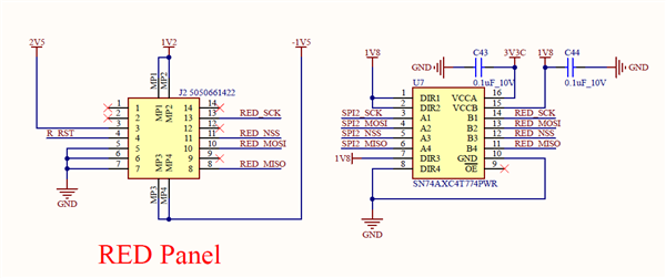

We are using SN74AXC4T774PWR Voltage Level Translator for SPI in our design, Here we are not able to translate the data from 3.3V to 1.8V and Vice versa.
On VCCB Side we are unable to detect the 1.8V Logic on data lines it is displaying about 0.8V.
On VCCA Side we are getting 3.3V on data lines.
Can you please advise on this, attached schematics for your reference.
Note: OE pin is tied to GND to Enable Outputs.
