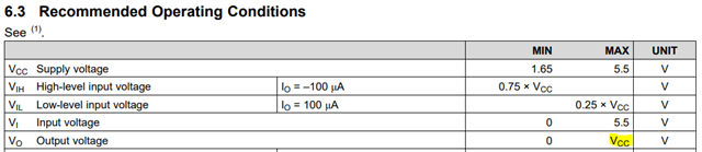

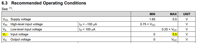

We are using the SN74LVC1GU04 and I have a few question about it:
  1. Can the VCC be 5V and at the input of the component the signal voltage will be 2.85V?
  2. VOH at 3V is 2.3V (min) what is the max value ?
  3. VOH at 2.3V is 1.9V (min) what is the max value?
  4. In the first page it wrote that “Inputs Accept Voltages to 5.5 V” does it mean it 5.5V tolerant (which mean I can use VCC of 2.5V and the input signal can be 5.5V)?

    The maximum VOH is VCC. It also depends on the output current.
    The input indeed is overvoltage tolerant.

    The input signal can be above VCC.

    This device has no positive input clamp diode therefore this device can handle input voltages from 0 to 5.5 V regardless of VCC. Please see this FAQ for more details. As long as VCC is within the 1.65V to 5.5V range this device will work.

  • Hi Shay,
    1. Can the VCC be 2.5V and at the input of the component the signal voltage will be 2.85V?
    Yes. The inputs can be up to 5.5V, independent of VCC.
    VCC
    VCC. See question 2 above.
    Yes. See question 1 above.
