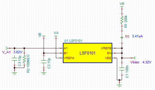

Schematic is attached.
We have VrefA set to approx 3.6V and VrefB set to 5V. We measure "solid" rails at these voltages.
However, VrefB and EN at the LSF0108 chip (Pins 19 and 20) which are "driven" by the 200K/0.1uFD network "droops" to a significant lower voltage when doing data transfers.......as low as about 2V. With no data transfers, we are seeing about 4.5V (ie, about 500mv less than the 5V VrefB). This is causing erroneous PCI transfers.
Somehow the transfer activity is "feeding through" to the Vreb/EN inputs of the LSF0108 chips.
Can we reduce the 200K to something significantly smaller? The LM4051ADJ shut regulator should be able to "sink" whatever current is required through the reference FET.
The purpose of this circuit is to "limit" 5V PCI transfers (VIO = 5V) to 3.6V so as not to blow out the FPGA that is on another page. The FPGA handles the PCI transfers.
We like the series FET style level translators, since they are essentially zero-delay devices.
We like the LSF0108 because it has the internal FET "calibration reference" establishing a precise "threshold voltage" based on the 3.6V VrefA. That is, the FPGA should not see a voltage greater than 3.6V, which is OK for this FPGA.
But, we don't understand why the VrefB/EN to the chip (pins 19 and 20) are not stable during data transfers!

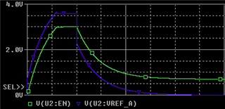

  • Hey Joe,
    I can't write up a long response - I have to leave in a minute - but I wanted to give you a quick note here.
    I have already been running some simulations and what I've seen so far is that the LM4051 drops off, I haven't figured out why yet.
    The green trace is at the EN pin of the LSF, and the purple is at the VREF_A pin.
    Are you seeing the same effect in your system?
  • Two quick things - I don't see any difference with changing the bias resistor, and the time constant of the droop appears to be directly linked to the 470 ohm resistor + the capacitor placed at the enable pin. Again - no answers yet, but I wanted to share. I should be able to look when I get back in about 30 minutes.
  • Emrys
    YES!!!!  Looks like simulation is reflecting reality (for a change)!   Stefan is going to get Scope image of VrefB/EN on one channel and VrefA on the second channel - triggered off of a PCI cycle (such as FRAME).  He said he would have that tomorrow (Thursday).
    So, perhaps you can see something in the simulation and determine the "why" in the meantime.

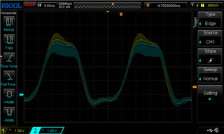

  • We have previously captured some traces.
    The following trace shows VrefB Power Supply (Yellow) and VrefB input pin #19 (Blue). Traces was taken with all 8 data lines simultaneously going low and then 30ns later simultaneously going high and repeating about every 200ns. VrefB at the input pin does not appear to vary
    The following trace is the same setup but repeating the transfer every 4-5us with 50us delay every 16 transfers.
    The following trace shows a Data Transfer trace capturing a Data Bit during a PCI Write. B Side (PCI is driving) in Yellow, A side (FPGA) in Blue during heavy load (200ns repeating transfers).
    The following trace shows the VrefA Power Supply during heavy load (200ns repeating transfers). VrefA supply is yellow, GND is blue, and differential output (VrefA - GND) is purple. Note that there is some small noise but otherwise the VrefA does not droop. The Cursor A and B values are for the differential out
    For reference, the following trace shows the PCI Clock U9 p17. B Side (PCI is driving) in Yellow, A side (FPGA) in Blue with 1s persistence.
    I have noted that the number of data bits that is toggling and the speed at which there are toggling has a direct impact on the VrefB input pin voltage.
    Stefan

  • Thanks Stefan for posting the scope shots, this is very helpful.
    There's quite a bit of undershoot, which may be an issue -- beyond about -0.5V the negative clamp diodes will activate and can cause variations in the local ground for the device (maybe why the ground looks so noisy). Probably not anything you can do about that without a major redesign though. This could affect the body voltage, which can cause threshold variations and thus clamp voltage variations.
    The most likely culprit for the issue you're describing is going to be charge injection causing the gate voltage to drift internally. It would explain why everything looks fine at DC, but at higher data rates and with more channels switching the clamp voltage shifts. That voltage is directly related to the gate voltage, and the gate voltage is stabilized by only an external capacitor -- which works very well for lower frequency signals, but at higher frequencies, it may not be sufficient.
    This would explain why I can't easily replicate it in my simulation software - I'm using simplified models that won't give me that kind of detail.
    Would it be possible for you to add a pull-up resistor (330 ohm would be good for a test) to 3.6V at the A side pin on one of these channels? If the issue is related to the gate voltage stability, I would expect that to fix the issue.

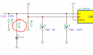

  • I think there might have been confusion on the pullup and which side it is connected to. The "A" side is the FPGA side. Note this currently has an approximately 25k pullup to 3V within the FPGA.
    To CONFIRM you want us to try pulling up the "A" side to VrefA with a 330 Ohm pullup?
    Stefan
  • Hey Stefan,
    If possible, yes - I would like to see if that eliminates the positive voltage variation.
    You could also try a larger resistor size, however I expect 330 ohms or less is required to impact such a fast signal.

    We changed the 200K ohm to 1K ohm on one of the LSF0108 chips, and that seemed to solve the problem on that chip.   We are going to change the 200K to 1K on the other chips.
    With the 1K change, the VrefB/EN node goes up to 4.8V with no activity on the buss.   Previously, it was at about 4.4 volts.
    Can you run your simulation with:
    A. 1K ohm instead of 200K ohms on the VrefB/EN to the chip
    B. VrefB rail set to 5V.
    C VrefA rail set to 3.6V
    C. 5V voltage source driving into one of the "B" side data I/Os.
    D. What is the resulting voltage at the corresponding "A" side?   If you need a load on the A side, try 10 Meg, 1 Meg, 100K, 10K.
    Thank You,
    Joe Norris

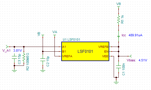

  • Hey Joe,
    I would expect the voltage to increase some at the output when you increase the bias current since that will also inherently increase the overdrive voltage for the bias circuit.
    Here's my simulation results with the original and new setup into a high-impedance (100MEG) load:
    The level 1 MOSFET model is good enough to show that the output voltage is expected to increase from 3.62V to 3.81V, however it's not good enough to show the other effects such as parasitic leakage and sub-threshold operation - both of which are likely playing a role in the DC voltage increase you're seeing.
    With an extremely high load impedance, the voltage can drift up using voltage-clamp based translators like LSF. Usually it's not an issue since most inputs have at least a bit of leakage, but I've seen similar issues with very high impedance devices.
    Usually the solution is to add some resistance to ground (1meg is usually sufficient). This provides some channel current that prevents the FET from ever fully entering the sub-threshold region. With a smaller load resistance, we would expect the output voltage to drop to ~ 3.8V with a 1k bias resistor.
  • Emyrs,
    This is looking good.   We are seeing 4.8V instead of 4.51 volts for the "Vbias" node in your second simulation, above (ie, with 1K resistor).
    I have a better idea of our "load" going into the FPGA.  If you could please replace the 100MEG resistor with a 3.0 Voltage source and a 25K series resistor, that would be what the FPGA is presenting as a load.   The FPGA is being programmed so that it has a "pullup" resistor (i25K) and the FPGA I/O power rail is set to 3.0V in our design.
    Your help has been much appreciated, and I suspect we can close the case with this final simulation!
    Thank You,
    Joe Norris

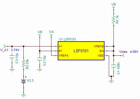

  • Hey Joe,
    I adjusted the simulation as requested and reran the DC values:
    I also included a copy of my simulation file below (for Tina-TI), in case you'd like to tinker with this further.
    LSF_Bias_Change.TSC
  • Emrys,
    I downloaded the latest copy of TINA.   I added some voltage meters.  Revised .TSC file is attached; "JPN" in file name are my initials.   For some reason, I'm getting 3.57V at the V_A1 node while you are getting 3.74V.  Why?
    LSF_Bias_Change_JPN_032122.TSC
    Node_Voltages.TXT
    Thank You,
    Joe Norris
  • Hey Joe,
    Your pull-up resistor is 1k.
  • you are correct, Emrys.  I fixed and reproduced your result.  Thank You,  Joe Norris
