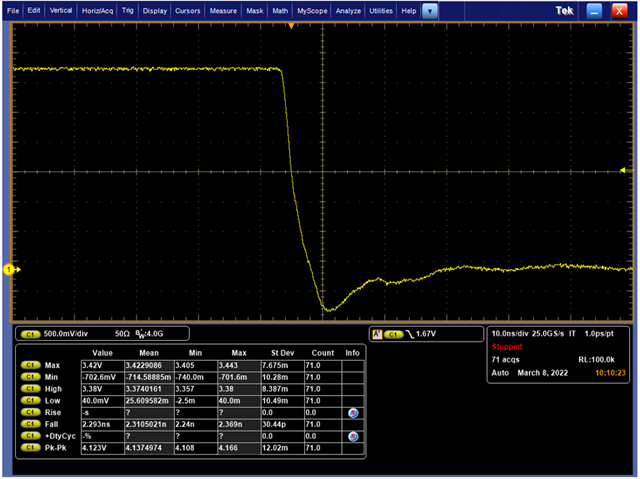

Hi Team,
Customer finds the negative undershoot value is near to -0.7V sustaining ~5ns. In my understanding, as long as customer guarantee the current into port less than 50mA, which should be accepted here, right?
Stanley
