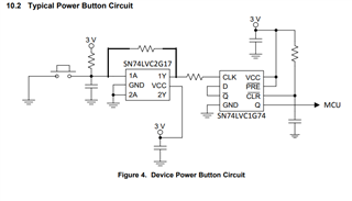

A bus-hold circuit is not in series with the signal, but attached to it at one point; see my schematic above.
Why are you showing a power-button circuit? Does this have anything to do with your application?

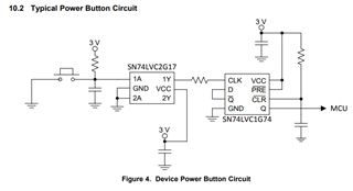

Dear Clemens,
This is example design which is taken from SN74LVC2G17 datasheet.
As per this application design, bus hold circuit is connected in series . Below is the schematic for your reference from SN74LVC2G17 datasheet
Bus hold circuit ha to be attach to the signal (for ex: 1A pin has to be connected to any of the signal which we need to hold, 1Y should be connected to same pin 1A with series resistor).Is my understanding is correct?
That example in the SN74LVC2G17 datasheet does not show a bus-hold circuit but a button debouncing circuit. Ignore it.
Your understanding of the bus-hold circuit is correct.
