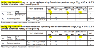

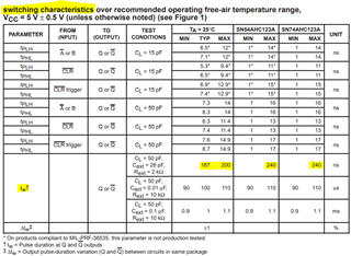

Good Day. I have a customer who is working with SN54AHC123A. Please see below his query for your reference. Thank you very much.
I am looking for support in generating edge triggered pulse widths between 10 and 25 ns. According to the sn54ahc123a datasheet: https://www.ti.com/lit/ds/scls352h/scls352h.pdf it appears that according to pp. 5 a 5 ns output pulse is possible. However an app note I found: https://www.ti.com/lit/an/scla014/scla014.pdf?ts=1649785130686&ref_url=https%253A%252F%252Fwww.google.com%252F says on pp. 3 that the minimum output pulse duration is 290 ns (but this seems in conflict with the datasheet--in particular pp. 11, fig. 5--though that app note is no longer linked on the product website so maybe that information is out of date). Can you achieve pulse lengths as short as 10-25 ns with that part, and if so, how can that be achieved? If not, is there another part I might consider? Thanks,
