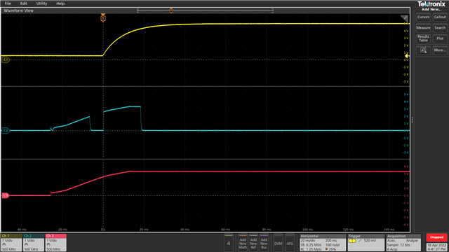

  • Is there perhaps some issue with the power supply ramp? As I mentioned in my original post I am using the same part on the same board where VCCA is 3.3V and VCCB is 5V without any problems.
    In the first scope capture trace C1 is VCC_3V3, trace C2 is an output (pin 10), trace C3 is VCC_5V. Input pin 5 is tied hard to VCC_5V, OE is tied to VCC_3V3. All other inputs and all outputs are unconnected.

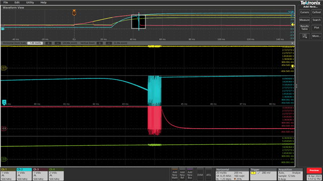

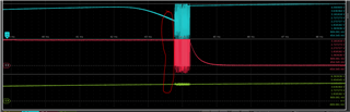

    In another experiment the input is tied to VCC via a 1K resistor. In that case the input appears to be pulled by the part down to about half of VCCA and then after some chaotic activity on both the input and output, the output eventually drops to ground. See the second scope capture.
    Here C1 is VCC_3V3, C2 is input pin 5 (pulled to VCC_5V by 1K resistor), C3 is the output pin 10, and C4 is VCC_5V. OE is tied to VCC_3V3.

    This shows about 1.8 V across that 1k pull-up which indicates ~1.8 mA through it. If this current was constant, I would assume damage to the input causing a short to ground. However, since there is a time where there is minimal drop across the pull-up, I'm lead to believe there is something else connected driving the input low during the falling slope. Are you certain there is nothing else connected to the input other than the pull-up? Are you able to monitor supply currents for the configuration where the input is shorted directly?

    You are actually looking at the input signal in the first scope image. C1 was on the input pin (5) of the device, which was tied to VCCA (by replacing the 1K pull up to VCCA with a jumper). C2 probe is on the output (pin 10), and C3 is connected to VCCB (which is the bench supply input). OE is tied to VCCB.
    I have already eliminated obvious problems like shorts and bad connections, having verified everything at the actual pins (vs pads) of the part.  Other inputs are disconnected, and all outputs are disconnected. Although I do see the same behavior on other inputs if I set them up the same way. Unpowered I have measured the resistance to ground on the outputs at about 28K. The resistance between outputs is basically open.

    Irrespective of wether the input is tied high or pulled-up, the part settles into a state where the input is high and the corresponding output is low. To me it appears that the part has gotten into a strange internal state. I'm going to try making some changes to the power supply timing to see if it changes the behavior of the part.
  • Regarding the second capture, I have not measured the supply current over time, although I could do that. It's steady state is about 49mA. The input eventually springs back to a valid high level (although the output is then invalid), so whatever is pulling it low seems to give up. But tying the device input directly to VCCA eliminates the possibility of external actors (see capture 1).

    What is pulling down the input in capture two?
    Why does it oscillate from rail to rail at the input? - This is something you can expect to see holding a CMOS input close to 1/2 VCC (like in the scope capture), but the oscillations would be seen at the output side not the input. Not only that, but this device has Schmitt-trigger inputs which would eliminate this type of behavior due to the added hysteresis.

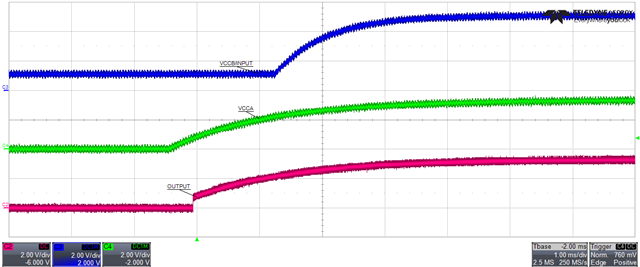

    I managed to perform testing on this device, but my results were as expected. I couldn't exactly replicate the long ramp you had for the supplies, but I followed the sequencing order. I also monitored the current into the input during the ramp and it never went above ~1 uA, which is likely why I saw identical performance between shorting the input directly to VCC and using a 1k pull-up.
    Now I am more curious to see the results of you testing when adjusting the ramping and/or using a new unit to confirm there is no damage to the current one.
    I'm attaching my waveform for you to analyze. Let me know if you have any questions on it.
