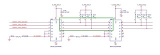

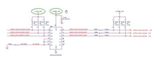

Hi team,
1can this IC can be applied to the case where VCC supply voltage is not the same as the Aport input pull up voltage?
 2. can this IC can be applied to the case where the output of level shifter is directly connect to the input of the other level shifter?
