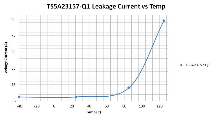

  • Hi Clemens
    Thank you for the quick reply and for pointing to the AUP family, these are helpful comments.
    Hopefully the above chart should be labelled "uA", otherwise it might be a bit scary for my customer ....Blush...
    Best regards
    Ueli
  • Hi Ueli,
    Note that the plot above is not for the SN74LVC1G17 -- it is for the TS5A23157-Q1. I do expect that the units are incorrect -- I doubt a CMOS switch has 95 A of leakage current at the input Slight smile.
    to generate a large and accurate time constant (safety function)
    If accuracy is required, I would recommend against using an RC + Schmitt-trigger logic gate. The input thresholds of a logic device will be fairly wide.
    I would recommend to look into a comparator + voltage reference to give the most accurate timing based off an RC.
