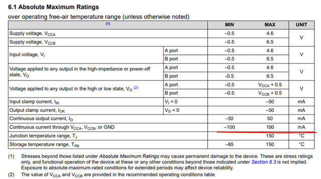

Hi expert,
The VCC supply current of TXB0104 is only several uA, however, the absolute maximum ratings is 100mA, why you add so big buffer here? Is there any design consideration? Thanks.
Arie
Hi expert,
Arie
Hi Clemens,
Thanks for your reply. If VCCA is 3.3V and VCCB is 5V, what's the power consumption of the VCCA power rail? Thanks.
Arie
Hi Arie,
Static power consumption for VCCA is listed as ICCA. The value you are seeking is shown in the screenshots you provided - 5uA
