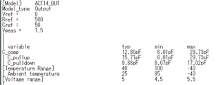

HI team,
Customer want to get IBIS model in the case of 4.9V, 5.1V.
Custmer noted voltage range between 4.5V, 5V, 5.5V user can set, but they want to have 4.9V and 5.1V.
is it possible to provide it?
  • Hi NY,
    We won't be creating a completely new IBIS model for every possible voltage - the purpose of the model is to provide the ability to simulate at many voltages.
    Your customer's IBIS simulator should have the option to change the supply value. They just select the closest model for their use case, then modify the supply in their circuit. The simulator will make the appropriate adjustments.
