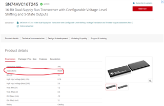

  • Are there any level shifter that are specified for RGMII level shifting?
    the SN74AVC16T245?
  • Hi Hielki,
    The SN74AXC8T245 is still fairly new so I haven't really seen proof of other customers using it. However, I have seen customers use the previous generation SN74AVC8T245 for 1.8 V to 3.3 which is pretty much equivalent to your scenario. When asked these are the two devices I recommend. The 16 channel version could also be a candidate, but I think 8 ch is typically chosen for flexibility in routing.
    I would have more confidence in the 100Mbit operation mainly due to how strict the timing requirements are for 1000Mbit. In my opinion, it doesn't seem like they spec'd that protocol with the intention of have some interfacing device between the MAC and PHY (very little margin) especially with how critical even the layout routing is.
    In the future, this is a gap we would like to close with a translator so if there is a next generation to this system I recommend coming back to see if we have a better solution that we can guarantee operation for 1000Mbit.
