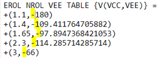

Hello Sir/Madam,
My name is Junesang Lee, responsible for EDA simulation in Altair engineering.
I'm writing you because I'd like to ask about things where I got in trouble with the spice model(SN74AUP2G14.cir). Just to put the more information, I compared two cases in the simulation tool below,
Case1: SN74HC14.cir <-- running well
Case2: SN74AUP2G14.cir <-- failed
So, it would be great if someone/expert could take a look at the problem. And two spice models and a description(.pptx) including questions have been attached. Please refer to them. Thank you!
[SN74AUP2G14]Spice simulation problem.pptx

EROH NROH VEE TABLE {V(VCC,VEE)} =
+(1.1,150)
+(1.4,102.352941176471)
+(1.65,104.210526315789)
+(2.3,103.896103896104)
+(3,60)
EROL NROL VEE TABLE {V(VCC,VEE)} =
+(1.1,-180)
+(1.4,-109.411764705882)
+(1.65,-97.8947368421053)
+(2.3,-114.285714285714)
+(3,-66)

  • Hi Junesang,
    1. The meaning of A/B  is the Ron resistance of the output FETs of the device when outputting a logic LOW at the supply voltages specified in the datasheet. The values on the left are the supply voltages specified in the datasheet and the values on the right specify the Ron resistance at that supply voltage.
    The values for the Ron resistance in the SN74AUP2G14 model are negative, they should be positive. This should fix your simulation.
    2. A has three lines because the SN74HC14 datasheet only specifies electrical charactistics for supply voltages at 2V, 4V and 6V.  The SN74AUP2G14 has electrical characteristics specified at 1.1V, 1.4V, 1.65V, 2.3V, and 3V.
    Sebastian
  • Hi Sebastian,
    Thank you for your clarifying the minus value in Ron section. One more thing, may I ask why the minus value is expressed in the resistance? I was wondering If the situation could happen in a certain spice model. So, I'd appreciate it if you could explain to the basic/principal when this minus value is being created so that could be handling correctly the value(e.g. absolute value) in the simulation tool.
    P.S. If possible, we can make a c.call to discuss. So, it would be nice if you could let me know the possibility which you are able to call. My email address is junesang@altair.com
  • Hi Junesang,
    Our modeling expert is currently out of office until tomorrow, would you mind waiting for a reply until tomorrow? He can give you a better response as to why the minus value is expressed in the resistance.
    Sebastian
  • Hi Sebastian,
    Thank you for the reply. I'm waiting for it.
    Junesang
  • Hi Junesang,
    I spoke with our modeling expert, this minus value in the resistance is just a mistake. Many of our models were created from scripts that use datasheet specs to generate a model. This has led to a few of our models having mistakes like this. In this case the Ron resistance was negative because the script likely pulled Iol data from the Vol spec in the electrical characteristics table with the wrong sign.
    Sebastian
  • Hi Sebastian,
    Thank you for your confirmation. I'll use it as a reference when developing.
    Junesang
