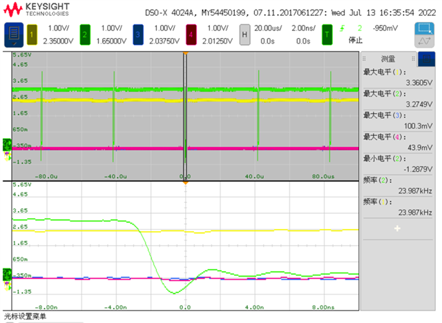

Hi teams,
Can Pin14 /G handle the negative input signal with -1.3V less that 5ns? And do you have any suggestion for this issue?
Please kindly refer to the pic below for details.

Hi Marsh,
The maximum negative input voltage for this device is -0.5V. This rating can be exceeded as long as the input current ratings are not exceeded:
