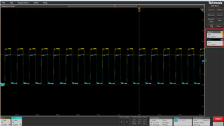

My customer has a question. Is it normal for the SN74AUP2G34DCKR output to be slightly lower than the input?
CH1 is input, CH2 is output, the difference between the front and rear is 0.52V

This is a buffered device; the input and output are isolated.
The SN74AUP2G34 drives the output to VCC, but the drive strength is limited. Any load (e.g., a pull-down resistor or a LED) will lower the voltage. See the VOH specification.
AUP outputs have an impedance of about 60 Ω, so that 0.5 V drop looks like the effect of a load of about 8 mA.
