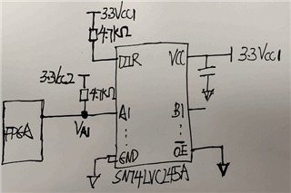

SN74LVC245A: What is the impedance of A port when VCC power down, /OE=GND?
Part Number: SN74LVC245A
Hi experts,
My customer want to design a circuit as below.
What is the impedance of A port when 3.3VCC1 power down, /OE=GND? My customer need to ensure that the port A maintain high impedance when 3.3VCC1 power down, /OE=GND, becaues they need to ensuse VA1 =3.3VCC2.
Thanks!
