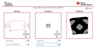

The Footprint for package X2SON (DPW) does not match the part. Am I looking in the right place? Is the footprint CAD file for X2SON (DPW) available somewhere else?
Hi Gricel,
Sorry for any confusion this has caused. You are looking in the correct spot for that part, but it seems like the wrong pin-out was uploaded to the web. If it's just for modeling purposes the SN74AUP1G125 have the correct footprints. If you are going to be using this model for simulation then I recommend using the one you found and simply not connecting or grounding pin 5.
