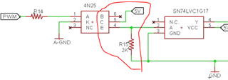

    the purpose is to pass an isolated  pwm control signal from a mcu to a driver ic on the other side, attched below is the schematic:
  • There are several 5 V single-channel buffers. Because of the slow output of the optocoupler, a Schmitt-trigger input might be a good idea, so use the SN74LVC1G17.

    Can you please take a look and advice if the schematic bellow is correct? and if all the resistors and capacitors/Values as noted also needed(R15,R16,R17, C9, C10)?
    I can't be certain of this circuit:
    This is not a TI part, and it looks like they have configured it as a common collector amplifier. Just looking in the Vishay 4N25 datasheet, it seems that the more standard configuration is common emitter, like this:
    What they have may work -- I'm afraid I don't know and they would need to do the circuit analysis or contact the manufacturer of their opto-isolator to get more information.

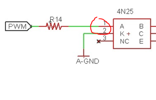

    My recommendation would be to design the circuit the way the manufacturer recommends, and if an inversion is required, that can be done at the LED inputs.
    If the PWM input is connected to pin 2, and pin 1 is tied to the positive supply (not sure what the voltage range of PWM is), then this would reverse the polarity of the signal and invert the output, without having to use the common-collector circuit that has limited voltage range.

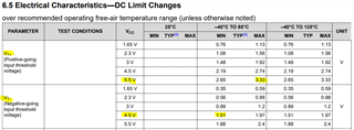

    For the SN74LVC1G17 operating at 5 V, I would recommend that a "HIGH" input be larger than 3.33 V, and a "LOW" input be smaller than 1.51 V to ensure the input is recognized correctly.
    The SN74LVC1G17 should have a 0.1uF bypass capacitor connected from the supply to ground placed close to the device.
    The output loading is no problem - with a 6kohm series resistor the output current is limited to less than 1 mA, which is far below the limitations of the device.
