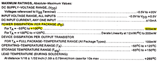

* Junction Temperature (Tj) (°C):
* Theta-JA (°C/W):

    FYI - the max junction temperature for this device is 150 ºC, which is listed in our logic FAQ section here: [FAQ] What is the maximum junction temperature (TJMAX) for a device?
    Also, for the R_θJA specification, this device doesn't list an R_θJA, but instead provides the maximum power dissipation:
    The purpose of R_θJA is to calculate temperature increase from power dissipation to ensure that the device can function under a specific set of conditions. In older devices like this one, a flat value was provided, so if the device is being operated with 500mW or less of power dissipation, then it can operate from -55C to 100C.
    We can use this to calculate an R_θJA if you just really need one, but for normal operation, the highlighted values are what should be used.
    For the calculation:
    R_θJA = ( TJ(max) - TA(max) ) / P_D = (150 - 100) / 0.5 = 100 ºC/W
