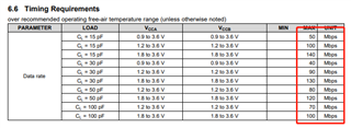

In section 6.6, the max data rate when (vcca=vccb=0.9) is 50Mbps. What is the equivalent frequency that can be applied from the function generator to chip?
Or other way, how the data rate is calculated in section 6.6? What are the merits or limits of the output signal since the output signal gets worst as the frequency goes higher and higher
  • Hello Farman,
    The relationship between frequency and data rate (Mbps) is rather complex but in simplistic terms; Frequency = 1/2*(Data rate). In the example you have provided, 50 Mbps is about 25MHz.
    In the graph that you have selected, the capacitive load is increases while the overall data rate decreases. Furthermore the size of the load has a direct impact on the frequency that the device can communicate at. On the other hand, increasing the values of Vcca and Vccb for similar capacitive loading allows for higher data rates as well. Note that we cannot guarantee good signal integrity if the operating frequency is outside the recommended range given in datasheet.
