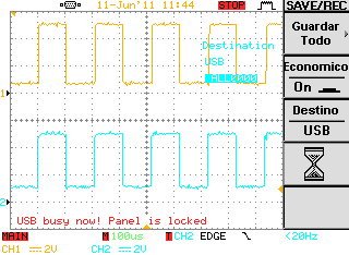

    I solved the problem with the fullduplex to halfduplex converter connected to TXB0108.
    The problem was the resistance R9 (see schematic), I changed it for a 180 Ohms value (it also works with resistances in the range between 90 and 180 Ohms) .
    I attached the image captured for the osciloscope with the shape of pulses in Tx(channel 2) and Rx(channel 1).
    It may be useful for someone else.
