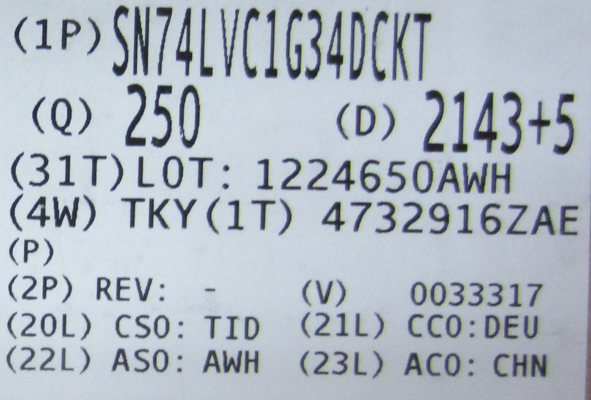

I would like to know if we can use SN74LVC1G34DCKT instead of SN74LVC1G34DCKR.
Is the difference between the two is only packaging?

For both of them, there are three manufacturing sites. So regardless if it's R or T, you could see three different X-rays.
You mean even they are the same parts, the x-ray would differ between different manufacturing sites?
And this would occur on other parts as well I suspect?
Hi, is it possible to find different x-ray for the same part from the same manufacturing sites?

Hi Clarence,
We do not have anything like this. If you have worries about authenticity, I can check the date codes of the devices.
However, Clemens is correct: since we have so many manufacturing sights, it is completely possible to see different x-rays.

What makes them think the parts are not genuine TI products? Are they not ordering from a TI authorized distributor?
Hi Emrys,
They got the parts from Digi-key, who claim the parts were fetched from TI directly.
Then they found out the X-ray were different from the part they were using, so they wants to check for authenticity.
Yes, Digi-Key is an approved distributor of TI parts - there is no reason to question their authenticity.
Hi Albert,
Do you mean different X-ray is impossible for the SAME sites?
May I ask how many manufacturing sites are there in China right now?
As far as I know, a single manufacturing site does not change its lead frame. But it is possible to get devices from multiple manufacturing sites, even on the same reel.
