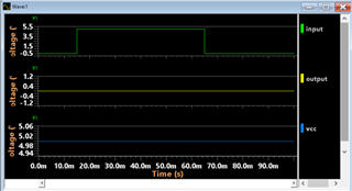

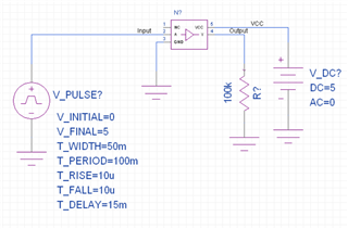

Here are some details.
It's a very simple circuit just to confirm functionality
Output waveform shows 5V VCC input, a 5 V pulse at the device input and nothing at the output.
The devices is configured for the 5V model.
I'll just have to dig into the AMS manual more to find out what's going on I think.

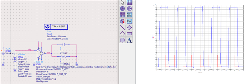

That's interesting - I've never seen an IBIS simulator that shows the full device like that - usually it's just an output with a trigger pin.
I actually use the LVC1G17 model fairly often since it's a good example of the LVC family of logic. Here's an example simulation from ADS:
