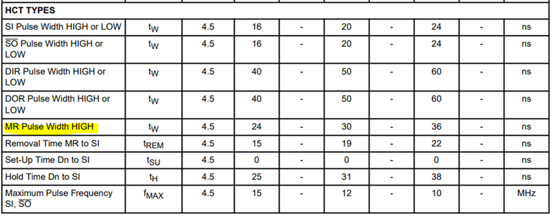

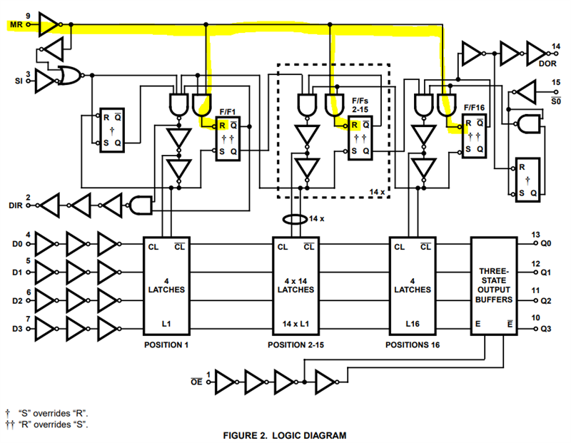

    The MR input is level controlled, but requires a minimum pulse width to properly operate.
    You can see the exact logic functionality here:
    In the "Prerequisites for Switching" section of the datasheet, the minimum pulse width for the MR input is defined:

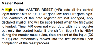

    No, the MR input is level triggered, it is not edge triggered or pulse-width triggered. As long as the MR pin is held HIGH while the supply is within the recommended operating voltage range and the minimum pulse width is provided, then the device's memory will be cleared. Note my answer above in regards to allowing the device to stabilize prior to starting operation.
