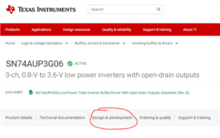

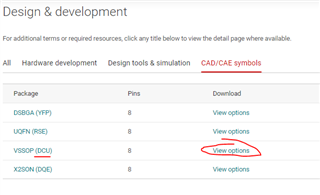

Hello Kato-san,
For any TI device, I would recommend to use the Ultra-librarian tool to download the appropriate footprint information.
From the product folder, click on "Design & development"
Then click on "CAD/CAE symbols"
And finally select "View options" for the appropriate package
This will take you to the Ultra-librarian site and will give you options for the type of editor you use.
