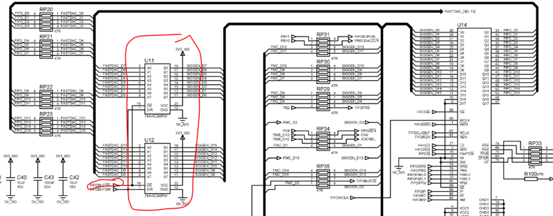

I have an application where a 74V293 is connected between a microcontroller and a parallel DAC to provide an "elastic" buffer between the two, and to enable the data to the DAC to be transferred at a well-controlled rate.
I've tried with a few variants of the 74V293, including the EP version, and the -6 and -7 standard product speed grades.
Most of the time it works fine but, in this application, about once in every 200 times the data coming out of the FIFO isn't the same as the data going in.
There are no obvious causes.  For example, I monitor the full and empty flags, and they're never asserted.  All aspects of operation look the same both when the output is as expected, and when it isn't.
The schematic is shown in this thread: https://e2e.ti.com/support/logic-group/logic/f/logic-forum/874433/sn74v293-unexpected-offset-value
Only D0-D15 and Q0-Q15 are used, since the output drives a 16 bit DAC.  The FIFO is configured to operate as a 65536x18 memory.
Data is written to the FIFO in bursts of 8192 values.  Readout is at a constant 25MHz.  The data written is cached by the microcontroller, so is written at an average rate of about 30M values/s, but is actually written in even shorter bursts that are several cycles in length, and have an even shorter cycle time.

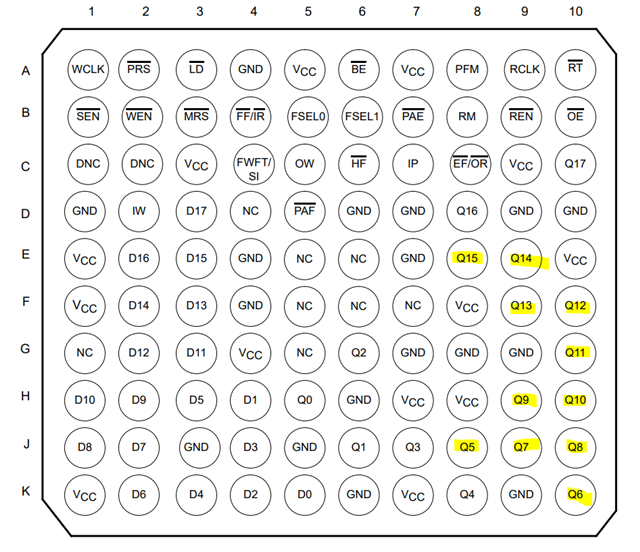

The top yellow trace is the DAC output: ignore that.  The blue traces are, from the top, REN, RCLK, Q2-Q15.
It's clear that whenever an output bit transitions from low to high, all the lower order bits, as far as and including Q5, then toggle for the next 8 RCLK cycles.
For legibility the screenshot only shows a selection of bit transitions.  But the phenomenon occurs at all low to high transitions of Q5-Q15, including the non-existent transition of Q16.

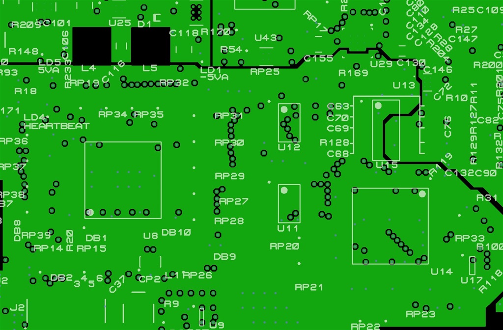

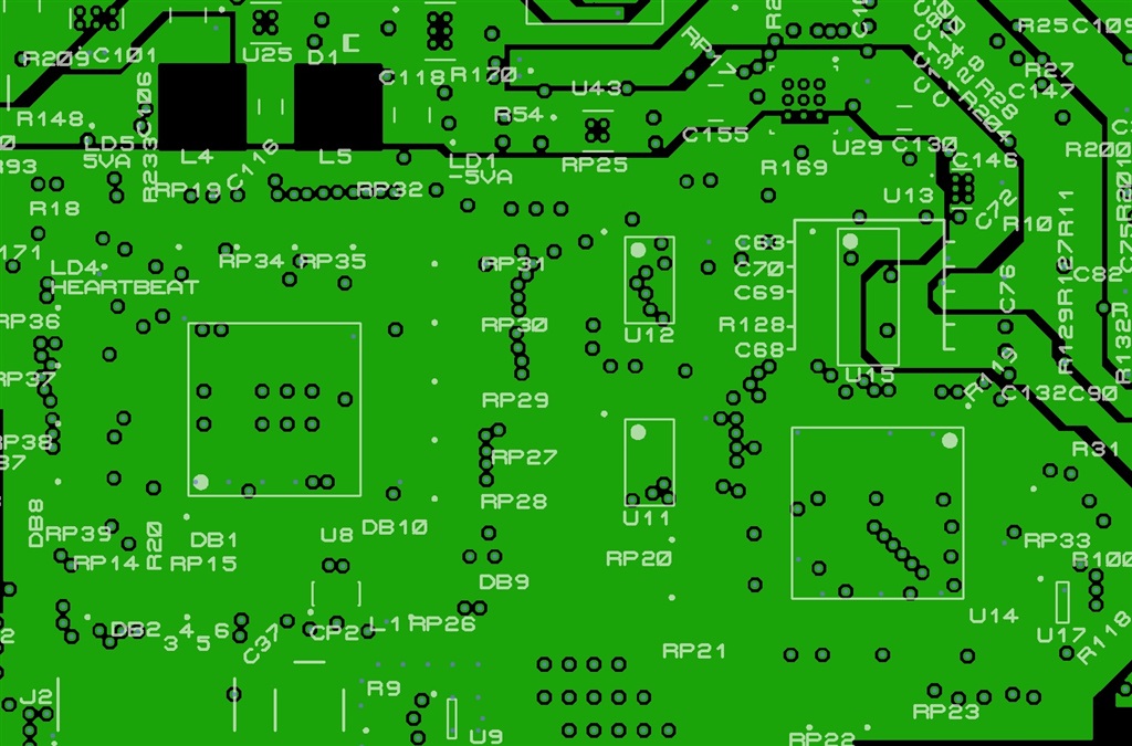

    Layout issues can result in cross-talk and reflections that might cause incorrect values to be either written or read out from a device. Is it possible for you to share the board layout?
    If you can't share, I'd recommend you to review the ground plane / power planes in the board and verify that they aren't significantly cut near the channels in question affecting the impedance and crosstalk of the signals. At least on the BGA, these pins are very near each other:
    It may also help to observe the wire delays on the input side from your test points -- it's probably not an issue, but it can't hurt to see if anything is significantly different that might cause the timings to be closer than expected.
  • Hi Emrys,
    A colleague of mine found this issue a while ago, but hadn't reported it to me until recently.  Because it was an intermittent and occasional issue that wasn't causing serious problems they'd put it to one side.
    The older post you mention is the one I linked to because it includes the relevant section of the schematic, to save uploading it again.  The older post was a different issue, but does relate to these parts.
    On this board I use the QFP package.

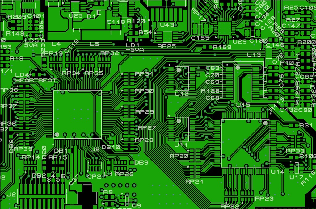

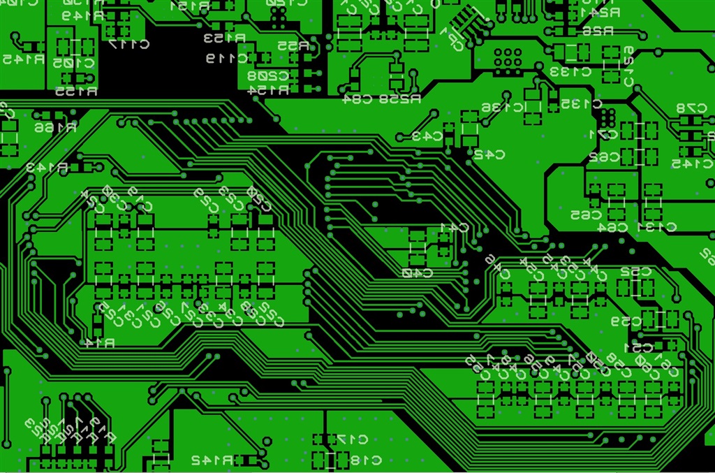

    The board is 4-layer, with local ground and power planes and double-sided assembly.  The following images (better resolution this time!) are the area around the processor and FIFO, in order of top copper, ground plane, power plane, bottom copper (I'm not going to put the manufacturing files onto a public forum, but the images should give a good idea of the layout: there aren't any cuts in either the ground or power planes under the processor and FIFO).
    I've kept the top side legend on all but the bottom copper so they're easy to align.  On the bottom copper I've used the bottom side legend since there are components there (the bottom side is mostly used for decoupling capacitors, of which there are many).
    The issues affect all the data lines.  The total trace length of each of the data lines does vary, from a minimum of about 35mm to a maximum of about 70mm.  The write clock trace length is about 95mm.
    I wouldn't expect those differences to create a difference in edge timing of more than a few hundred ps, and that's being pessimistic.  Given the setup and data time requirements, even a small number of ns of timing difference shouldn't cause a problem.  And, as I noted, the problem persists if I extend the data setup time in the microcontroller external bus configuration.

    Your layout looks good to me - it was a bit of a long shot idea.

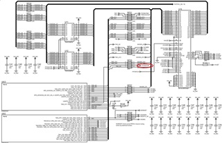

    Would it be possible for you to force a disable condition on these two buffers and see if the issue continues to exist? My colleague here suggested that there's no protection for bus contention between this device and the DAC or FIFO, so it may be an intermittent issue there.
  • Hi Emrys,
    The buffers are disabled when the output signal is being generated.  It would be complete chaos on the output if they weren't!
    It's easy to miss signals on the schematic, though: the buffer disable signal is highlighted here:
