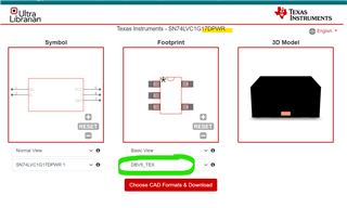

Our customer is looking for the PCB footprint for SN74LVC1G17DPWR which is apparently missing on our website.
Request TI team to add the PCB foortprint, and other relevant CAD & CAM support for the mentioned package.
Also, we see the CAD file for this device: Ultra Librarian for TI
The footprint file available on Ultra Librarian are apparently for part SN74LVC1G17DBVR (SOT-23 package, DBV code) instead of the required part# SN74LVC1G17DPWR (X2SON package, DPW code).
In this sense, it can be said that footprint provided on Ultra Librarian (UL) is incorrect (please notice "DBV5_TEX" on UL) for the mentioned package variant. Please refer to the datasheet for package land patterns and compare with UL footprint.
Hope my point is clear. Or else, please let me know if I am missing anything. I hope you can help us and also provide a footprint for SN74LVC1G17DPWR.
