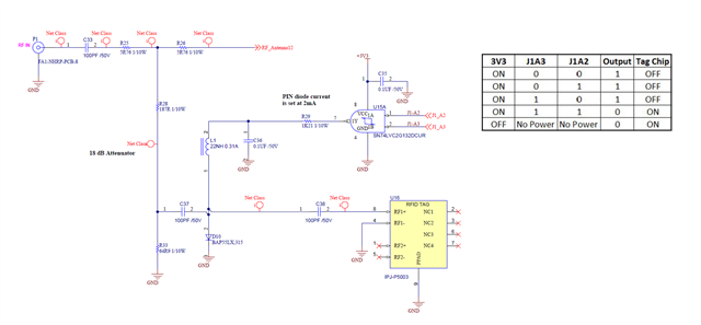

We are receiving an impedance error on MPN SN74LVC2G132DCUR, the measurements made to detect a defective U15 component is with the following method:
Using a Digital multimeter, with the ohmeter we measure 2 test points:
Between ground to A2& A3 points (pins 1&2 from component U15) from connector should be a Megaohms reading.
Instead of this, the measurements are only kohms in a defective component U15.
Normally on a good component U15 the measurements shall be megaohms, and not Kohms.
the failure rate is around 0.31% at SMT and 0.22% at HLA.
I have attached the FA report & U15 failure docs
Please your help on this matter
