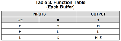

I'm looking at the SN74LV126A datasheet.
It says "The SN74LV126A devices are quadruple bus buffer gates featuring independent line drivers with 3-state outputs.
Each output is disabled when the associated output-enable (OE) input is low.
When OE is high, the respective gate passes the data from the A input to its Y output."
But table 1 indicates the opposite. Which is correct?

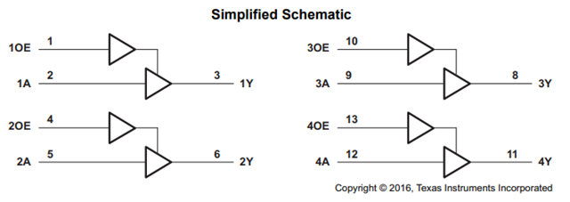

  • Hi Ray,
    Thanks for bringing up the additional threads; I will prioritize this update to reduce confusion among our customers.
    The '126 logic function is standard across the industry, and the correct information, applicable to all SN74____126 devices, follows:
