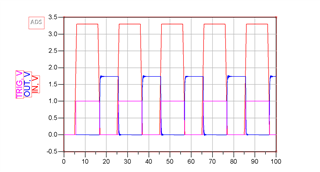

Hi :
I was using level Translator p/n  SN74AXC4T774PWR for SPI application as SPI master and Slave are working at different IO voltage level.
I have downloaded the IBIS model from TI website and used ADS platform for IBIS simulation . The schematic as shown below
IBIS1 acts input (A1 pin as input)   and IBIS2 acts as output (B1 pin as output) .
As per result the Output is inverted w.r.t Input
Looks like there is some issue with the IBIS model . Please check and revert back.
In case you have any result please share me the result

  • Hey Shamanth,
    It seems that you may have picked the inaccurate model for this simulation ("model io_3p3_z" contains the signal integrity for output =3.3V; input = 0.7V)- try using the model "io_1p8_x" for your simulation instead. I have attached an example of this IBIS model with your parameters.
