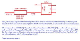

As per my understanding, max value of VOH should be same as VCCB.
Or can you please provide max value of VOH which is not mentioned in datasheet.
I want to translate 3.3V signal to 5V signal.
So, if I apply VCCA=3.3V and VCCB=5V, then VOH of my output signal must be 5V. But in datasheet, it is mentioned 3.8V for VCCB=4.5V.
Also, in the curve shown below, it is shown output=5V, but as per the table shown above, it will not be 5V.
