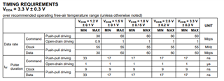

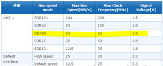

When driving SD cards with VCCA=3.3V and VCCB=1.8V, is it safe to assume that the TXS206 specs can support up to DDR50?
