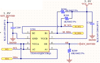

Hi team.
Good news that we design in the TXS0102QDCURQ1 and need your help to review schematic.
- VCCA 1.8VèModule other device I2C level
- VCCB 3.6Vè MCU I2C level
- should we control OE PIN by serdes GPIO?

Hi Jimmy,
Yes, OE may be controlled externally.
Are both A1 and A2 being pulled up to VCCA with a pull-up resistor.
Note that the device has internal 10K resistors and external pull-ups are not be necessary, if any concerns for VOL. If no concerns for VOL, this should be fine.
Please also see Effects of pullup and pulldown resistors on TXS, thanks.

Hi Michael,
thanks for your quickly reply.
I'm not pretty sure that do you mean we don't need external pull-ups? so we can remove R200 and R208 in the schematic?

Hi Jimmy,
Yes, with the internal 10K, you may remove R200 and R208, thanks.
