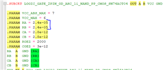

I have run into some issues with the PSpice models in PSpice for TI.
It appears that some of the ACT CMOS models are broken.
When placing them into a simple test circuit as shown below, the symbols pull WAY too much current:
I repeated this with other similar inverting buffer logic devices of HCT devices and they did not seem to have this issue (they have believable current draw):
It appears to be an issue with only AC or ACT component PSpice models.
I am using PSpice for TI version 17.4-2022 S008 Windows SPB 64-bit Edition. I observed similar behavior importing models into other PSpice software too.
