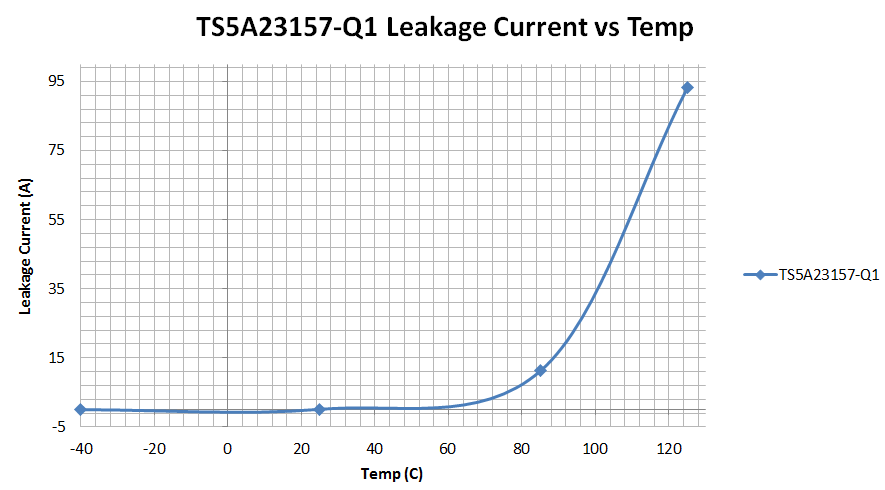

The datasheet for SN74LV139APW gives a specification for Ioff. First, I want to make sure I understand what Ioff means. Ioff is the leakage current to the output pins when they are in high-Z mode, correct? Also, I assume this is the current per pin and not total for all pins, is that right? Also, I want to see if I can get additional information about this current. If I have some weak pull-ups connected to my outputs (47kohms), is the maximum current still 5uA? Is there a lower value we can rely on when not directly connected to power?
