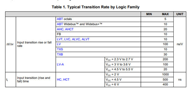

My customer has a question with below app note.
SLLA364A https://www.ti.com/lit/wp/slla364a/slla364a.pdf
For LV-A series, it is specified that the transition rate is Δt/ΔV=20ns/V(Vcc=4.5V to 5.5V)
My customer wants to know the voltage range used to specify this spec.
They guess that is will be from Vcc x 0.3~Vcc x 0.7 from VIL(max) and VIH(min) with considering the shoot-through current at the input CMOS.
From the document, it seems that it is measured from 10% to 90%.
What will be the voltage range for the measurement?
