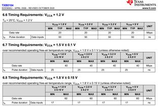

What's the maximum supported speed at Vcca = 1.8V and Vccb = 3.3V? The LSF0108 datasheet does not have the same Timing Requirement table as the one in the TXB0104 datasheet and hence the question.

  • The LSF is a passive switch. The speed of rising edges is limited by the RC low-pass filter formed by the pull-up resistors and the total capacitance of the traces/cables/other devices.
    66 MHz might be possible, depending on the capacitance, if the pull-ups are strong enough. Better use a buffered translator like the TXU0304.
