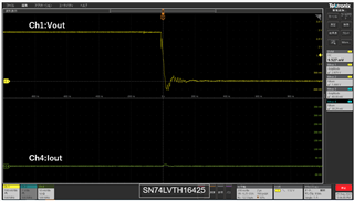

Hi all,
I would like to know the difference between SN74LVTH16425 and SN74LVTH125.
This is the waveform during short-circuit test for each device.
Ch1:output voltage
Ch4:output current
SN74LVTH16245ADGGR
When do the short-circuit test, output current flows for a moment and stops.

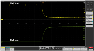

SN74LVTH125PWR
When do the short-circuit test,  270~350mA current continues to flow.
They seemto behave differently, but they are the same LVTH family.
Could you please advise why the behavior is different?
I would appreciate it if you could tell me the difference.
Ryusuke
  • The current that flows when shorting an output exceeds the absolute maximum ratings and is likely to damage the device. The behaviour under these circumstances cannot be guaranteed.
    I cannot tell you what happened in your tests without knowing the schematic and the exact test conditions. And it is possible that earlier tests already damaged the device.
