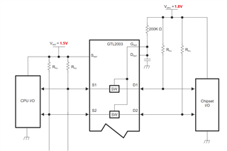

I am wondering how does SN74GTL2003 will work under the following condition.
I was wondering whether to install a pull-up resistor on the high side and low side in bidirectional translation, up translation and down translation when the low side is 1.5V and the high side is 1.8V?
  • The SN74GTL2003 is basically the same as the LSF0108.
    For when to add pull-ups, see section 5.2 of the LSF application note.
    Please note that the difference between 1.5 V and 1.8 V is too small to allow the highest speed. (You can connect the 200 kΩ resistor to a higher voltage; it is not required to be the same as the I/O pull-up voltages.)
